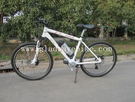

GLADWAY AM209
55,18 KB
Motor: 250W high speed brushless hub MID motor;
Battery: 36V 8.8ah Li-ion battery;
PAS: PAS sensor;
Controller: intelligent brushless. Power 250W 15A±0.5A;
Charger: AC 100V-240V;
Max speed: 25km/h (EU);
Range: Depends on battery;
Frame: aluminium alloy;
Tyres: 26" with Reflector;
Rim: Al alloy double wall and CNC side wall;
Front fork: Al alloy suspension fork;
Front brake: Disc brake;
Rear brake: Disc brake;
gears: 7 speed;
Rear derailleur: Shimano;
Brake lever: APSE alloy with brake off function;
Chain: KMC;
Chain wheel: al alloy crank;
Lighting: LED front & rear light on battery/ AA battery;
Price Offer: FOB $750/piece.

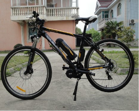

GLADWAY AM209-A
47,67 KB
Frame: Al-alloy 6061 T6;
Motor: Mid motor-ZF250w;
PAS: motor integrated torque;
Battery: Li-Ion 36v 8.8ah samsung/10.4AH samsung/panasonic 11.6AH;
Speed: 25 km / hour for EU Norms;
LED display 3 setup;
Brakes: Tektro disc brake front and rear;
Fork: SR Suntour Aluminum alloy & suspension;
Velo saddle, Vellgo Pedal;
Spoke: Stainless steel;
Wheel : 26"*1.75;
Tire: Kenda 26 inch;
Stem: Promax;
Gears: Shimano 7speed;
Chain: KMC;
Front headlight and rear reflector;
Charge time:5-6h;
Distance:>70KM;
Brake levers: Tektro;
price: usd$750(36v 8.8ah samsung);
usd$925(panasonic 11.6AH Hydraulic brake);
usd$850(36 v 10.4AH samsung Hydraulic brake).
