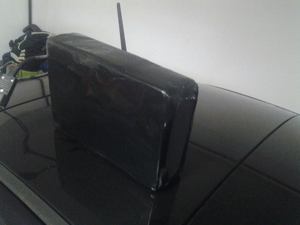

Secondo voi a che prezzo posso vendere questa batteria, mi rivolgo soprattutto agli esperti!
Ha fatto solo 30 ricariche, mai scaricata al massimo!!!
Fate delle offerte sensate
Caratteristica batteria:
Packing list:
1. 1Pcs 48V20Ah Li-Ion NiCoMn shrink tube electric bicycle battery pack. Included 13s polymer cells, 1pcs 15A continuous discharge current smart BMS.
2. 1Pcs EMC-240 48V4Amps Lithium Ion battery Aluminum shell charger.
Li-Ion NiCoMn Electric Bicycle Battery Pack Specification:
1. Normal Voltage:48Volts.
2. Dimension: 80mm X 185mm X 270mm.
3. Capacity: 20Ah.
4. Charge Current: 4Amps.
5. Maximal Continuous Discharge Current: 15Amps.
6. Maximal Discharge Current: 30Amps.
7. Overvoltage Protection: 54.6Volts.
8. Undervoltage Protection: 35.75Volts.
9. Lifecycle: 800Cycles.
10. Weight: 7Kg.
11. Chemical: Li-Ion NiCoMn.
Lithium Ion Aliminum Shell Charger EMC-240 Specification:
1. AC Input Voltage: AC90V~132V or AC200V~264V
2. Charge Voltage: 54.6Volts.
3. Charge Current: 4Amps.
4. AC Plug: Europen Standard or American Standard.
5. Power: 240Watts.
