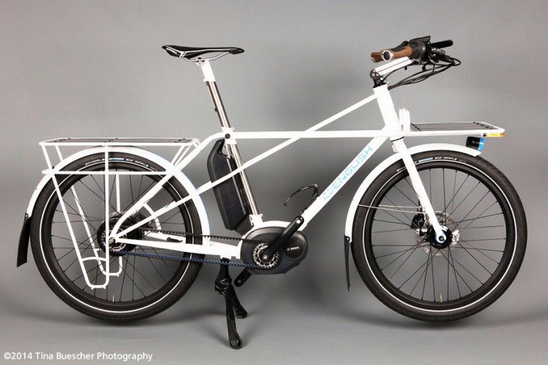

                       Inserito il - 15/02/2014 :  18:42:57
                         altra Cargo Bike col nuovo bosch
  http://www.e-bike-news.com/news/un-custom-e-bike/
