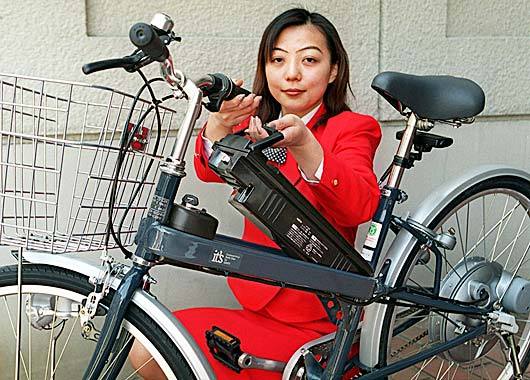

Guardate che una bici a supercondensatori già esiste, anche se non riesco a capire che caratteristiche ha...
Eccovi l'articolo:
And, Treehugger Michael Graham Richard1 noted in 2006 that at least European developers, such as BMW, have experimented with using super capacitors to give a quick, high-power, short-term “fix”. Professor Freymann favors the use of super capacitors over batteries for regenerative braking. “[The super capacitors] are lighter and store less power, but unlike batteries we can use all their power — all 100 percent.”
59,39 KB
