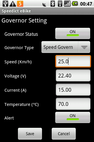

Oggi ho ricevuto questa mail:
Dear Customers,
Thank you for your past support of our products, today we would like to inform you that new firmware upgrade is available for download which is add-on to provides over-speed, current, temperature and under voltage cut-off, we called it "Governor" Add-on.
Without any hardware modification, all you need to do is connect your existing e-brake lever's electrical wire to Speedict eBike's "Brake In" port (used for secondary RPM sensor) and connect the "Brake Out" port (used for secondary temperature sensor) to your speed controller's brake input.
Whenever the cut-off point is reached (e.g. speed over 25km/h), Speedict eBike will simply send a brake signal to speed controller for cut-off action.
Should you interested to the Governor feature please download the firmware 2.1* from our website and Android client 2.1 from Android Market.
21,3 KB
Regards,
Speedict Development Team
* Java phone user please stay on 1.0 as Governor feature apply to Android smart phone only.
Adesso ci siamo !!! se come spero posso anche settarlo in modo che se perde la connessione blocca la bici ho fatto anche l'antifuto !!!

altri dettagli sulle nuove feature:
http://www.speedict.com/document/eBike-Governor-Add-On-Dec-2011.pdf
