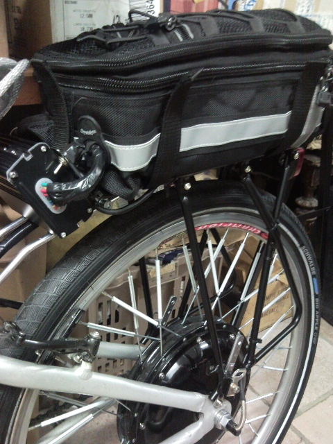

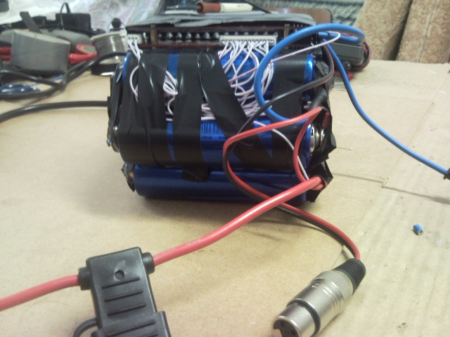

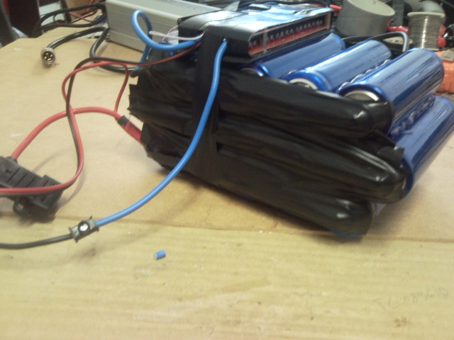

...ecco le foto del pacco finito...
119,1 KB
134,06 KB

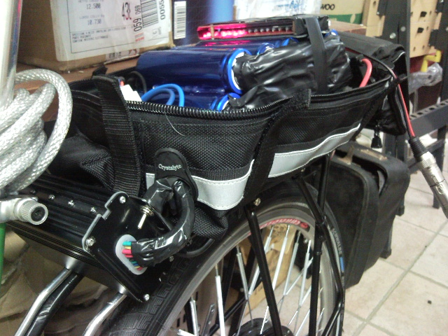

....ed inserita nella battery bag3 cristalyte....secondo mè un buon prodotto!
183,54 KB
I connettori sono tutti all'interno della bag e ho lasciato fuori solo la centralina da 500w; così si presenta a lavoro ultimato:
294,11 KB
..purtroppo oggi piove...e non ho potuto provare il tutto, tranne che a ruota alzata per verificare di aver collegato tutto quanto...domani forse la provo...

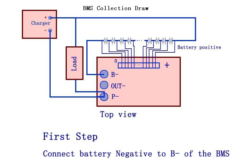

Il BMS di Jonathan (e anche il mio se mi arrivasse...) ha le seguenti caratteristiche, anche se poi in realtà ne è arrivato un'altro:
Battery Management System(BMS) for LiFePO4 16 Cells In series. It often use for 48V LiFePO4 battery pack. Specification: 1. Single Cell Over Charge Protection Voltage:3.9V±50mV 2.Battery Pack Over Charge Protection Voltage:68.4V±0.2V 3.Battery Pack Over Charge Release Voltage:56.8V±0.2V 4.Single Cell Over Discharge Protection Voltage:2.10V±80mV 5.Battery Pack Over Discharge Protection Voltage:38.4V±60mV 6.Battery Pack Over Charge/Discharge Protection Release Condition: Disconnect All Load to Recover to Normal State 7.Maximal Continuous Discharging Current:50A 8.Maximal Pulse Discharging Current:70A 9.Maximal Charging Current:20A 10.Battery Pack Over Discharge Current Protection Detection Current:100A±4A 11.Battery Pack Over Charge Protection Detection Maximal Delay Time:3seconds 12.Battery Pack Over Discharge Protection Detection Maximal Delay Time:1second 13.Battery Pack Over Discharge Current Protection Detection Maximal Delay Time:20milliseconds 14.Balancing System Working Static State Consume Current:200uA(The voltage of each cells is 3.2V above.) 15.Balancing System Working Static State Consume Current:20uA(The voltage of each cells is 2.0V below.) 16.Impedance:0.1m#937;(The voltage of each cells is 3.2V above.) 17.Dimensions: 10x60x135mm 18.Apply to 16 LiFePO4 Cells in Series 19.Installation method:Double Faced Adhesive Tape or screw 20.Working temperature range:—20#8451;-----+85#8451;
108,92 KB
Avevo salvato il sito al momento dell'ordine. Adesso non è più presente nel catalogo di BMSBattery.

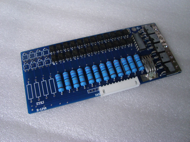

ATTENZIONE la corrente massima in scarica è 50 A ma voi avete 5 mosfet il mio era dato per le stesse
caratteristiche ma avevo 2 mosfet ..... mi hanno fregato .... destino ha voluto che mi si bruciassa
ancor prima di provarlo... probabilmente mi si sarebbe bruciato cmq per le forti scariche .....
i bms con pochi mosfet scaldano come delle stufe.....

Salve a tutti....proseguo con il mio report in merito alle 38120S comperate da bms battery:
allora...dopo 3 scariche complete ed un giretto con la bike di 25 km per far scorrere un pò di corrente dal pacco (20,5 A) sotto sforzo, aver ricaricato il pacco, e fatta una nuova ulteriore scarica completa al banco ho tirato fuori:
498 Wh e 9,870Ah con il bms che mi ha tagliato a 38v
In merito a questa ed alle precedenti scariche del pacco, ho fatto delle personali considerazioni:
mi sono accorto che con il nuovo bms (le cui foto sono alcuni post sopra..) che ha i led rossi sui rispettivi 16 canali, si accendono quando la singola cella è carica; cioè il led si accende e quindi quella cella per il bms è carica.
Succedeva che non tutti i led delle 16 celle si accendevano a fine carica del carica batterie, perchè il CB è tarato a 58,4v (3,65x16), e quindi, misurando le singole celle , ho riscontrato che diverse non erano completamente cariche (quelle con la luce del bms non accesa.
Il problema stà nel fatto che le celle sono cariche, per il bms, a 3,7 v e quindi quando 8 di queste raggiungevano la loro carica (con led acceso) , il CB mi staccava la carica e le altre non riuscivano a caricarsi completamente.
Per ovviare a ciò ho portato la tensione del CB a 59,2v (3,7x16) e in questo caso le batterie si sono caricate tutte (tutti i 16 led accesi) prima che il CB fermasse la sua carica.
Prima di giungere a tale tensione avevo provato ad alzare qualche millivolt partendo dai 58,4v di partenza e ho notato questo fatto....cioè che ogni volta che aumentavo di qualche millivolt lla tensione, una cella si caricava completamente (...si accendeva sempre un led in più..) fino ad arrivare ai 59,2 finali che mi ha acceso tutti i 16 led del bms (batteria carica).
La cella non corre rischi perchè sulle specifiche c'è scritto che la tensione di ricarica dei cellotti è 3,65-3,70v....quindi ci siamo.....e comunque c'è il bms che esclude la sovratensione delle singole celle a 3,7v.
Ora stò procedendo a ricaricare il pacco con la nuova tensione di 59,2 dopo la scarica appena effettuata. (prima della scarica avevo caricato il pacco con 59v e solamente un led non era ancora acceso allo stacco del CB.
Questo "report" è tanto per segnalare (a mio avviso...dopo queste prove e verifiche personali) che per caricare queste celle bisogna settare il CB a 59,2 e non a 58,4....altrimenti non si carica a fondo il pacco.
Questo l'ho appreso solo grazie ai led di segnalazione presenti sul bms.....se i led non c'erano, avrei pensato che le celle fossero scadenti dato che renderebbero di meno; il pacco complessivamente si carica per quasi il 20% in meno a 58,4v, con resa quindi solamente dell'80% !)

Mi è arrivato il bms di bmsbattery come jonatan ma quello a buon mercato senza condensatori
Già ci sarebbe da uccidere qualcuno.... Innanzi tutto non sono più quelli blu postati già sopra ma sono
rossi anche questi ma la cosa peggiore è che hanno 17 fili invece che 16 e dulcis in fundo hanno uno spinotto
separato per le ultime tre celle .... a dimenticavo.... mi hanno mandato uno spinotto solo che serve per le
prime 13 celle. Allego foto
come lo collego ? la zero va sul meno della batteria e la 16 sul più finale ?

Riguardando le foto mi sembra che sia identico al tuo jonatan
A te hanno mandato due spinotti per i fili che vanno alle celle ?
Se no come hai costruito lo spinotto da 3 ?

Ciao, si io avevo tutti e due gli spinotti, quello da 3 e quello da 13.
Guarda bene dentro al pacco o al nylon di imballaggio del bms...che magari non sia li in mezzo....dato che non sono collegati alle prese..
Il cavo con lo 0 io l'ho collegato direttamente al meno della batteria sul bms stesso.
Una curiosità.....quanti mos conti sotto la superficie?
Saluti

Jonatan il mio ha 8 mosfet

Finalmente mi sono arrivate le batterie da BMSBattery... Erano rimaste impantanate alla dogana di Malpensa. Il tutto mi è costato 65 euri di dogana... La prossima volta farò anch'io con DHL...
Da stasera mi metto al lavoro e posterò delle foto.
P.S.: anche il mio BMS è in edizione economica..., come quello di alex_audi.

@alex_audi: io ho un connettore a 14 contatti e uno piccolo da 3 contatti. Guarda bene negli abbondanti imballaggi...
@Jonathan: avevo detto economico perchè non trovavo i led... poi ho visto che sono semisommersi nella resina (spero sia resina trasparente....)
Inoltre il mio BMS ha solo 14 mosfet. Pensavo che ci volesse un mosfet per ogni canale ma evidentemente non è così.
Il mio dubbio è come collegare i terminali di potenza: B- OUT- P-
Voi come avete fatto?
Su questo sito http://www.ecitypower.com/index.php?option=com_content&view=category&layout=blog&id=38&Itemid=64 c'è un BMS esteticamente simile ai nostri, e danno questo schema di collegamento:
57,32 KB
Vi risulta? OUT- allora a cosa servirebbe?

Inserito il - 31/10/2009 : 11:30:53  Mostra Profilo Invia a Jonathan un Messaggio Privato  Rispondi Quotando
NO!!!! ATTENTO che è sbagliato.
Su B- attacchi il negativo del pacco batteria
Su OUT - ci attacchi il - che và alla centralina
Su P- il - del charger
Il positivo del carica batteria va collegato assieme al positivo del pacco.
Ricorda che prima di attaccare i filini del bms che vanno alle singole celle, di collegare il - del pacco batteria e non viceversa.
Si, i led sono affogati nella resina...e anche così fanno una luce fortissima (forse per quello li hanno affogati).
Beh...con "solo" 14 mos, hai una corrente di circa 60A....più che suff per le nostre celle con 5C di scarica. (ogni mos di solito dovrebbe gestire sui 5A continui e 7,5 di picco).
Jonathan
1062 Messaggi
Inserito il - 31/10/2009 : 11:35:23  Mostra Profilo Invia a Jonathan un Messaggio Privato  Rispondi Quotando
P.S.: Guarda a pagina 2....c'è uno schema esatto di come ho collegato il BMS.
